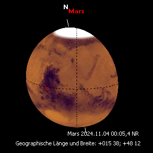

SC 9,25, Japanoptic APO 2x Barlow
ADC Pierro Astro Mark 2, ASI 224 MC
fps 70, 5 Min Pipp, AS!3, Fitswork
Die Winjupos Simulation was zu sehen war
LG Bobby
