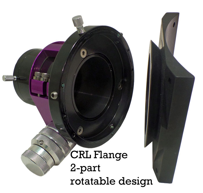

unterschätze nicht die Macht des Schwalbenschwanzes ;) Wie Dieter Lichtenknecker schon wusste, ist der Schwalbenschwanz die ideale Verbindung für alle Teleskopteile. Und wenn man ihn richtig justiert, ändert auch nix an der Bildfeldebnung (wie zb. der schwalbenschwanz an meinem 3" Steeltrack)
All current CRF flanges feature a 2 piece rotating flange design with a lock knob providing camera angle adjustment. It consist of an upper flange part and a lower flange part on a rotatable radial dove tail design. The upper flange part bolts on to the focuser body with 3 bolts. The lower flange part has the curve and 4 bolt pattern and connects in to the upper flange. This 2 part rotating flange system provides collimation ability using a simple 3-point push pull bolt/setscrew arraignment. Please note all focusers are factory collimated dead on before we ship them, and do not require any adjustment.
